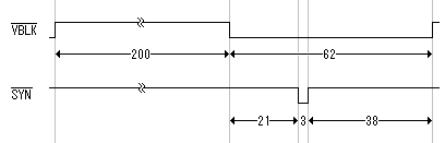

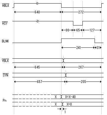

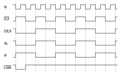

More details about NTSC using Φ(14.31818MHz) :
- horizontal timings:
- vertical timings:
- clock derivations:
