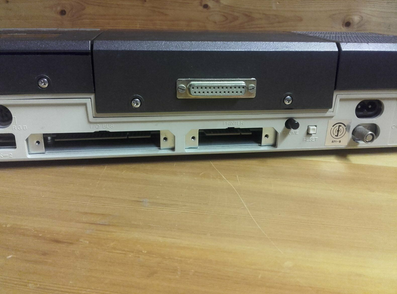

Hello friends,
I would like to buy MZ 700 for my collection.
This piece has some kind of expansion slot on the rear view. What is it?

Surely a parallel centronics connector. Inside there is a printer connector.

The problem is that the DB-25 was used for Centronics and for RS-232. You have to open up and look to know what it is.
The use of female or male connectors was up to the implementation in those days.

Ah yes, it is not centronics. Sorry. It a DB-25.
In https://original.sharpmz.org/mz-700/mothbrd.htm, see 24 : "The connector P-1 physically connects the plotter signals to the system". It could be connected to P-1. Can you use RS-232 and can MZ-700 read through this external printer connector or P-1 connector? The schematics seem to indicate you can only output data, not input data.

Still, without knowing where the connector is connected, you will only guess. It might be a (home built) interface board hidden under the cover.
A Centronics interface is still not impossible. There were Centronics interfaces that had DB-25 on the computer side and Centronics on the printer side. /Nils-Arne

Sure, it would be better to have a look inside: maybe there is card at the same height.

Thank you all. It is quite interesting to see how many home-built improvements can be seen in the world.

The only computer I know that use a male DB25 printer port and female DB25 serial port is the Amiga 1000, and even back in 1985 it was criticized for not having standard ports. So if you see a female DB25 on the back of a computer you can be pretty sure that it's a printer port.

From the position of the reset button and the volume control on the righthand side of the connectors indicate you have a MZ800 not a MZ700.
The large connector with the system switches and the joystick i/o port.
The small connector is for printer output.

Sorry to raise you hopes it is a MZ700, the "Sharp MZ700/8000 - EXPODED-" by John Simpson has the rear image of the MZ700 on page 5 as a mirror image.
The MZ800 rear image on page 6 is correct with the system switches visible.
Your image after saving and previewing, I can not see the switches.
