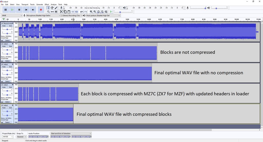

The question is interesting because I was tweaking a 12 minutes WAVE file into 3 minutes but without using a custom tape routine. I may plan to embed a tape routine to get the original 60KB wave file into a 1 minute loading by attempting 2400 baud or more. The original file uses a tape routine from Monitor ROM but it is an internal one so it may not work with a Japanese monitor.

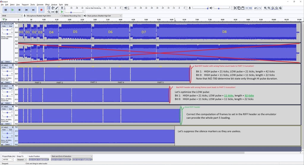

I can make my own tools to do that. The original WAV file was not readable on an emulator and has 9 blocks (1 header + 8 data) which is supposing to load over 12 minutes. Not only I built an artificial WAV with clean and optimized signals which loads in 6 minutes but it works with my usual emulator. And compressing each block with my mz7c tool, I have a WAV with clean and optimized signals AND compressed blocks which loads in less than 3 minutes.
Now the next step is merging the first three blocks into one and compress it as well, it will also act as a loader of the remaining 6 compressed blocks using a tape routine reading 2400 baud instead of the common 1200 baud and probably removing the ninth bit of a byte when reading. That would be great if I can then reach 1 minute.
That's just an experiment to toy with.
