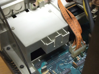

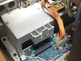

The MZ-1200 and MZ-80A have a lot of hardware parts in common: there is a connector which allows to add a color board (the engineers already thought about that addition):
*** the one for MZ-80A (pins are present) ***
*** the one for MZ-1200 (pins are not present) ***
And here the connector details:

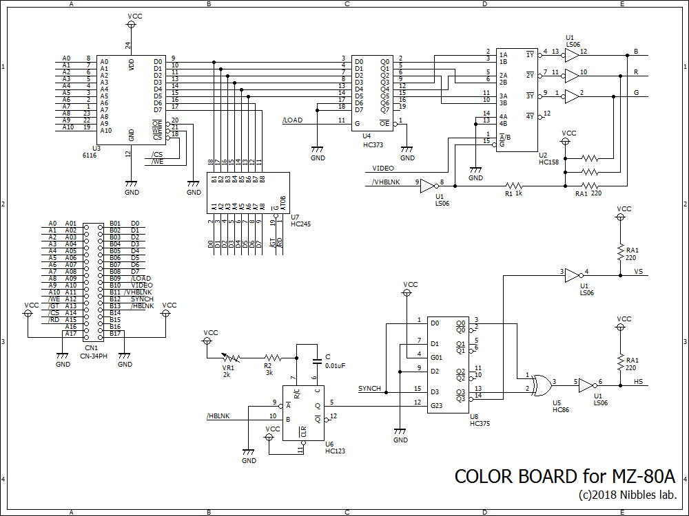

Interesting post seeing the Japanese GAL5 - the missing information. I built a colour board using Nibbles Lab schematic as the basis and need to make the DIN output, this will help a lot, thank-you for the information.
My board is at: https://eaw.app/sharpmz-upgrades-80col/

That's weird. From your page, the color format is:
Bit	Function
0	Background Blue
1	Background Red
2	Background Green
3	Character ROM Bit 0
4	Foreground Blue
5	Foreground Red
6	Foreground Green
7	Character ROM Bit 1
From MZ-700 manual:
Bit	Function
0	Background Blue
1	Background Red
2	Background Green
3	Unused
4	Foreground Blue
5	Foreground Red
6	Foreground Green
7	Character ROM Bit 0
As for that "MZ-80A mapping of the colour attribute RAM is different (page 167 of the user manual)", I wonder which manual you're speaking about.
I have two remarks after rethinking:
1) Having EUROPEAN/JAPANESE bit in ATTRIBUTE bits is not good: A Japanese game will have bit 3 set to 0 so it would be better to put the Japanese version selectable from U9 latch bits. Unless you have a way to invert bit 3 or not.
2) For CP/M, wouldn't an ASCII font be more helpful?
