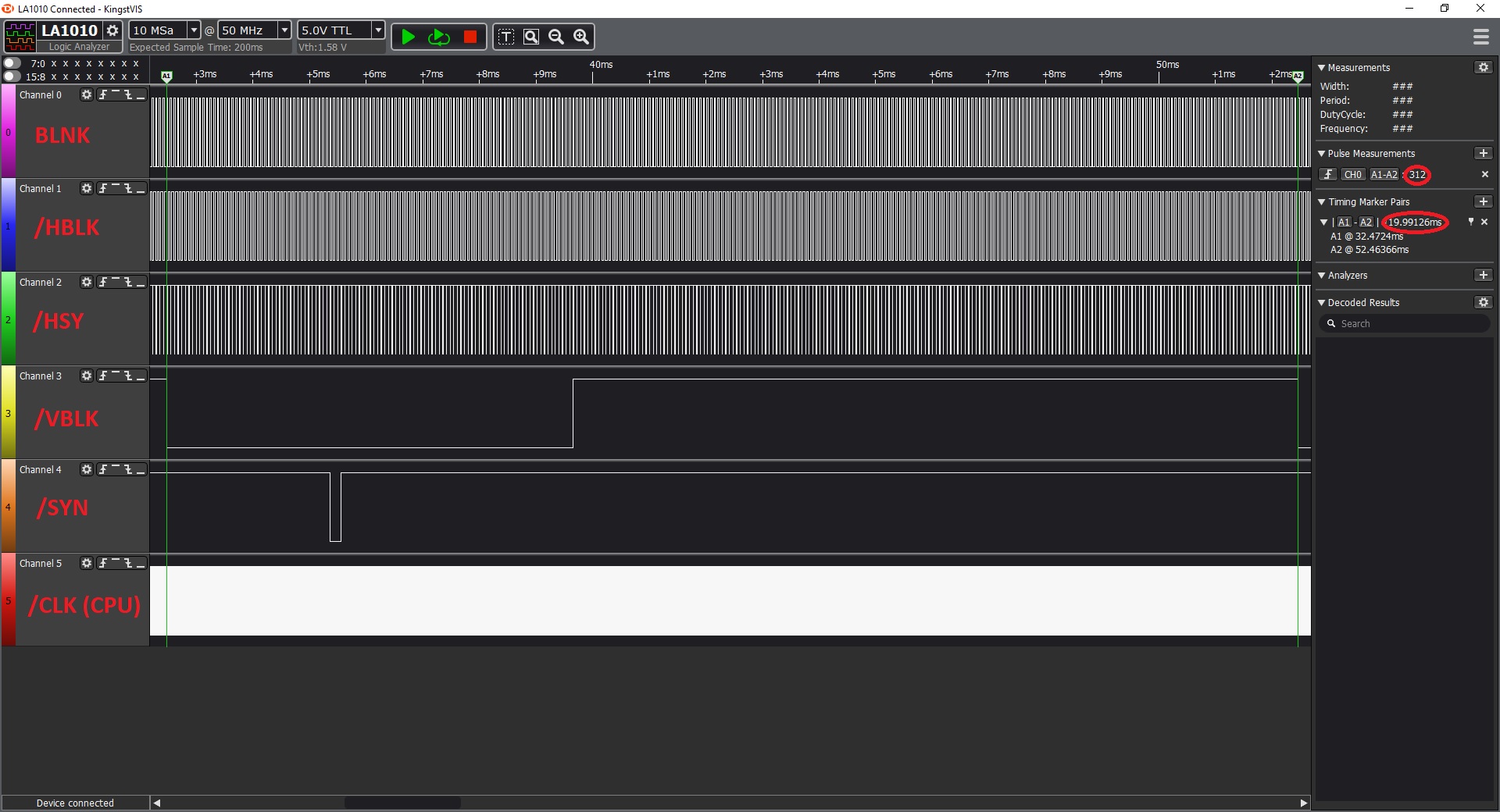

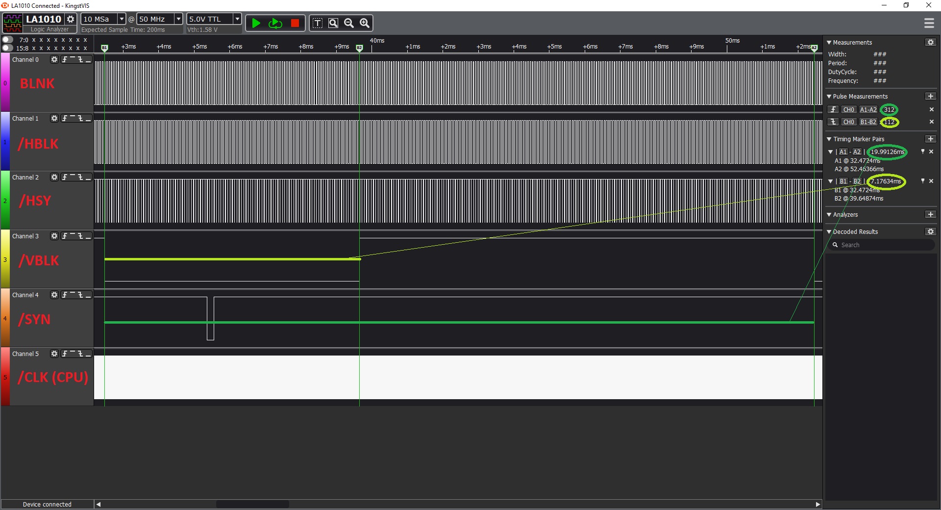

My logic analyzer tells me there is 312 BLNK signals per frame. So how does it happen the timer #2 is missing 6 BLNKs?
Re: [MZ-700] Vsync Checker
More precisely, the logic analyzer tells me: 312 - 112 = 200.
because the timers #2 is indeed counting two BLNK pulses as unit, I can imagine missing one unit but that would be 310. Here, we're missing 3 units.
