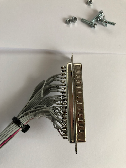

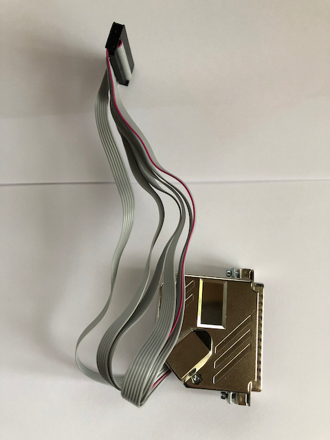

Thank you for the help. I made up the cable. Just waiting on the HxC and FI/O card to arrive. I also have a Gotek. Have you tried one?

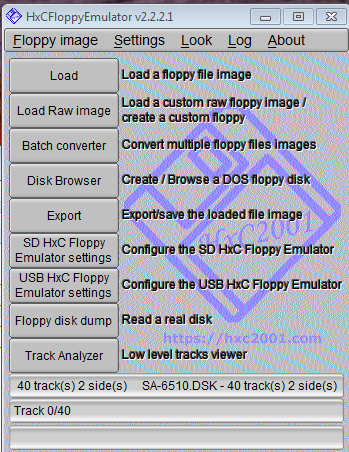

So while I wait for my HxC to arrive I downloaded the software and set to work on making some HFE images. Now the disk basic .dsk images give errors when I try to open them. Is there a tweak I need to use? the cp/m ones seem to work fine.

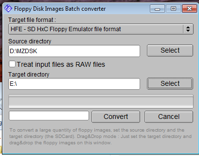

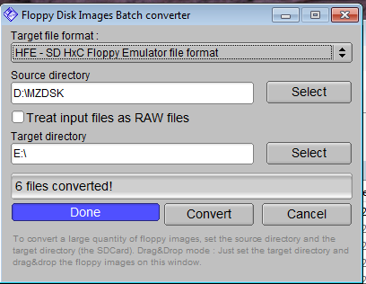

I just use the HxCFloppyEmulator v2.2.2.1 windows based program, place all the Sharp disks I want into a sub-folder and use 'Batch converter targetting the HFE exported files to the SD card used in the Floppy Emulator. Admittedly I havent done it for 2 years (how long it's been since I used the MZ80B) but it is the same procedure and settings for the 80A/800.

I tried the converter. I got 'zero files converted'. Do I need to change the .mzf suffix to .dsk?

I just checked the connections, assuming the IDC pinout is as per this link:http://www.hilmanind.com/pinouts/floppy.bak
34pin IDC 37pin D-SUB
1 NC
2 NC
3 NC
4 4
5 8
6 6
7 5
8 NC
9 9
10 10
11 11
12 12
13 13
14 14
15 15
16 16
17 NC
18 20
19 21
20 22
21 23
22 24
23 25
24 26
25 27
26 28
27 29
28 30
29 31
30 32
31 33
32 34
33 35
34 36

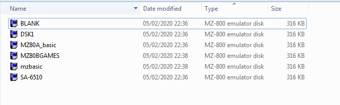

The MZF files are different to the DSK files, the former being the tape format used by Sharp, ie. a 128 byte header+data, the disk are different, they are in extended CPC (Amstrad) format, ie a dump of SA-6510 DSK:
