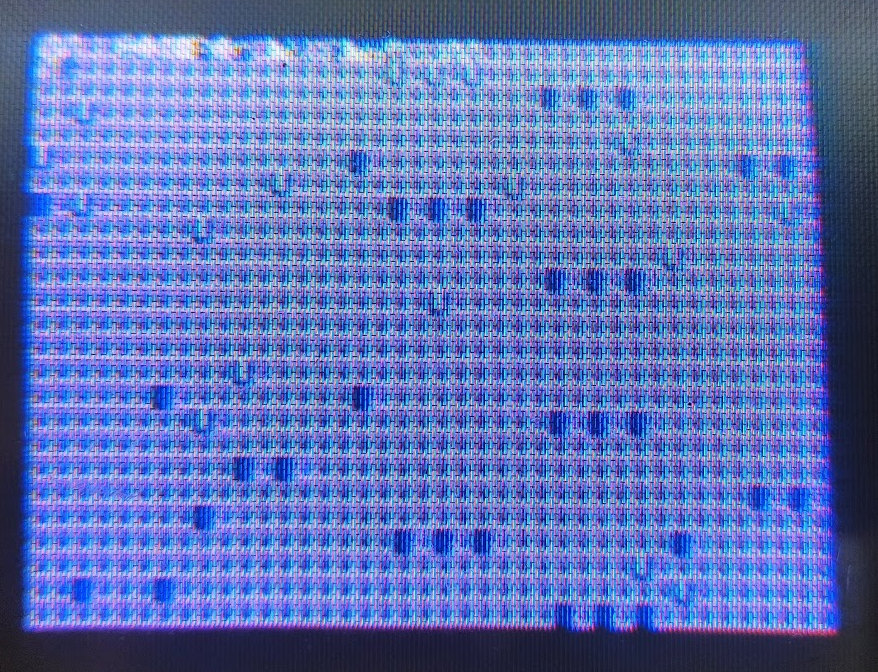

My next issue is a corrupt character map. It is reacting to the keyboard input. It alters when the system is reset.
I have found a defective 74S157 multiplexer on the board. Sadly I only have 158's, so I have ordered a replacement. Hope fully this will resolve my issue.

So you have first issue with DRAM. Since MONITOR ROM uses system data in DRAM, chance you're not able to go further as long as that issue is not corrected.

In terms of the screen, the character generator ROM loses its programming and can cause this issue, I had it on my MZ-80A, same kind of output.Check the CG ROM in an eprom reader if you can. It can be the mux devices but the eprom's were (back in the 80's) only supposed to hold their content for 10 years, quite surprised how may of them are still working today!!

The 74S157 mux are for DRAM, there is no such mux for CGROM. I just mean DRAM must be fixed to be able to go further. Obviously, it doesn't mean it will fix the CGROM issue.

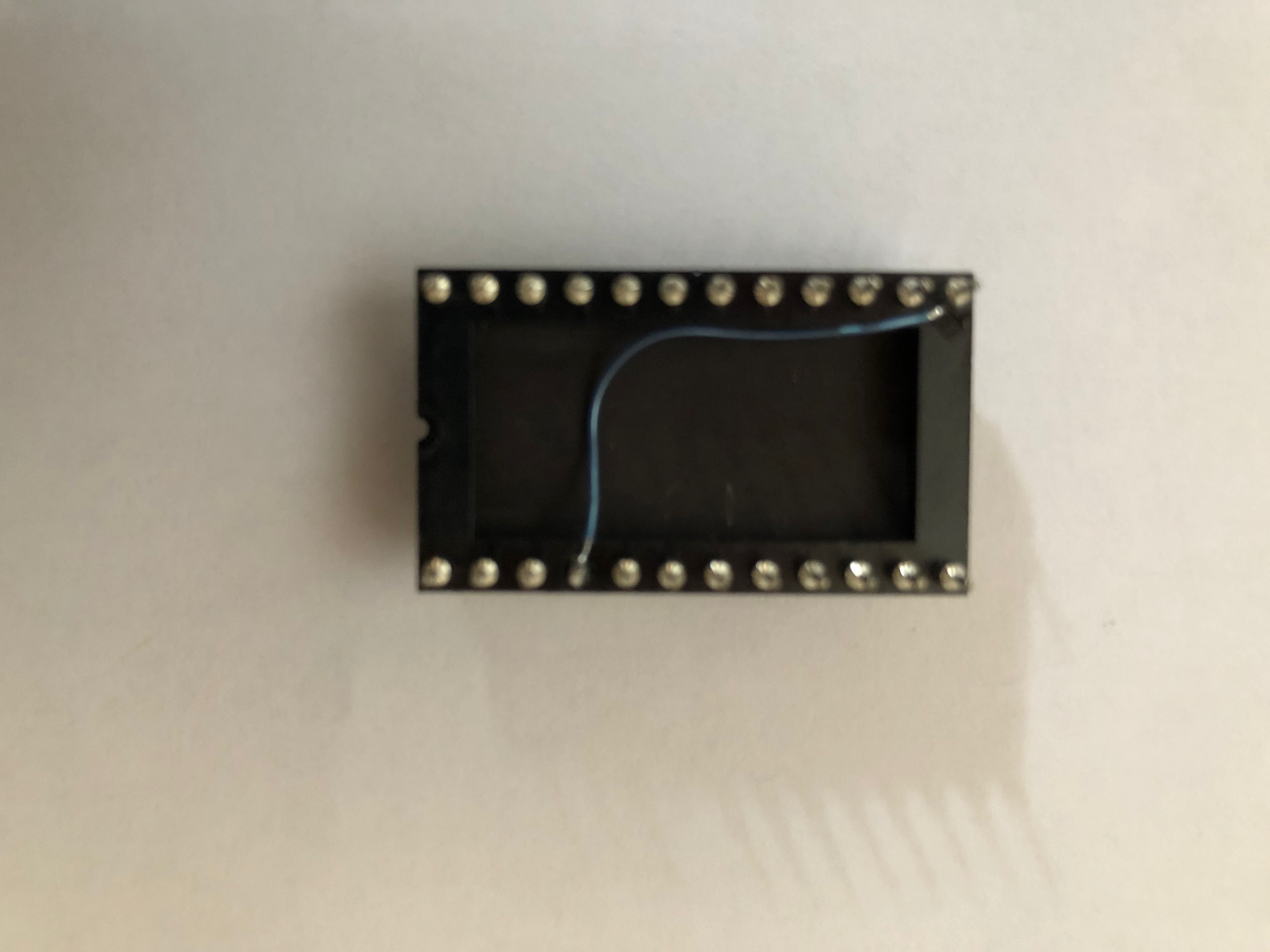

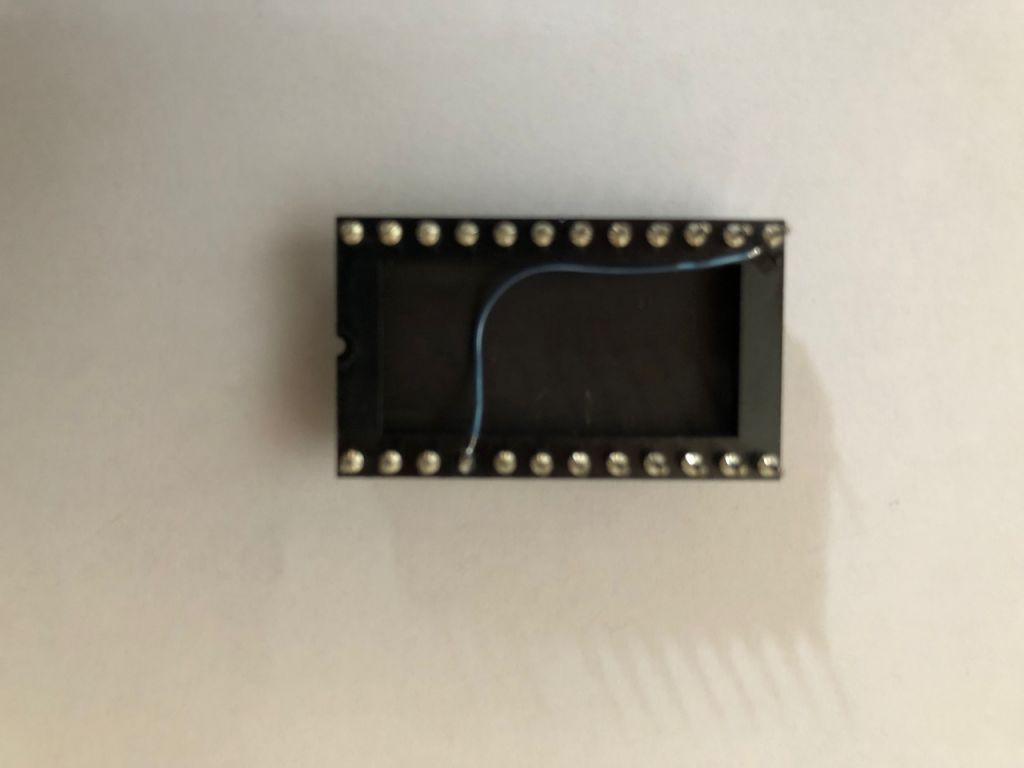

I use an XGecu Pro TL866 II programmer which I find very good, handles most devices. In terms of UV erasure, I no longer have a UV light (I should get one but prefer flash devices these day), what I did for the MZ-80A was to use the CGROM out of the MZ-700 (which survived my stupid 12V mistake) with MSB tied low.
For the OP, if you dont have an eprom reader then best I check to see if I have any blank 2732 devices that I could program up. Will check tomorrow and advise.

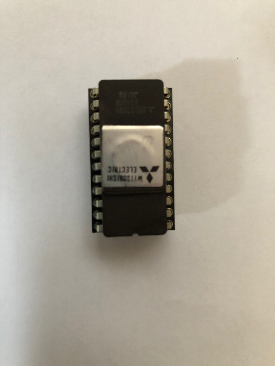

WRT character ROM, I do have a TL866II, if I need to go that route. I'll have a look to see if I have any 2732's. I Still have my UV box too! Can I just erase and re-programme the existing IC? Is an image available?
