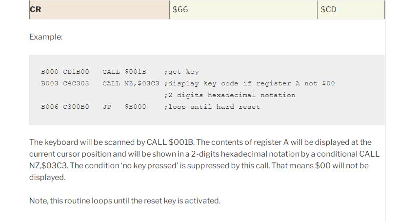

Well, I still have haven't done anything more interesting than writing a keyboard examination routine. It has had some improvements. I did just minutes ago, run the keyboard program on the real MZ-700. Up until then, it was only an emulator running on Win 7. For the most part, running it on the '700 works like it does on the emulator. However, there's one peculiarity... I can't get any results from pressing any of the function keys. I can't get results from F1 to F4 on the emulator either but F6 to F9 do work for me there. I'm guessing F1 to F4 not working on either platform is probably due to the particular monitor call I'm using for key input, but wanted to get answers from those with experience, so here's what I've assembled with Z80AS:

I do have other finicky/flaky keys that I suppose are not 100% due to the age and wear of the computer. I can get those to work by a little wiggling on the key itself. This trick doesn't seem to work for the function keys though. That's why I'm guessing it's the particular monitor call. Most keys do work surprisingly well for their age. Sadly, the space bar is one of the flaky ones.
