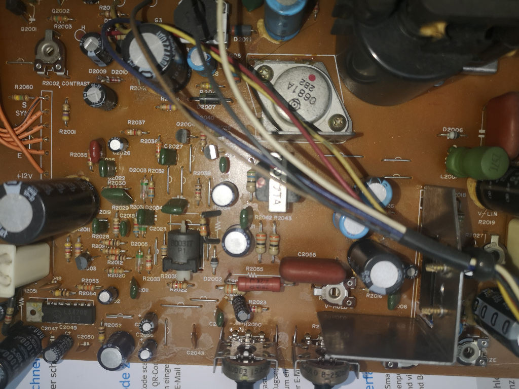

I recently decided to replace all the capacitors on my MZ-80A screen as the screen size was getting vertically smaller and couldnt be compensated with the vertical size/linearity (any attempt just started scolling). After completion, screen is back to full size, as per photo below and brightness is more luminance and crisp.

Ok, both resistor at their maximum - and I still do not see the flyback-lines.
Do you really mean, to replace ALL capacitors ? Best way to do it ? Replace one and check - then next ? Any special candidates to replace first ?

That is strange to not see the flyback lines, I have contrast turned to max and brightness about half way, any more and the flyback lines appear.
I made the decision to replace all given that electrolytics only have a limited lifespan as they dry out and most sources limit their useable life around 15 years. There is also a tantalum 1uF 35V which cries out to be replaced given a lot are going short circuit. The monitor runs quite hot so this will exacerbate the issue. It is also a lot of work to get the monitor out and separate the PCB to work with it on the bench so it made sense to change them all at the same time. I had another MZ-80A and the sound didn't work, all the signs showed it was the LA4200 Amplifier which I replaced and no change. I then took out the 3 electrolytics and one was open circuit, replaced and all ran smoothly.
The only other thing I can think of, not being a CRT expert is the gun/heater element or the phospor has aged. Both are not really replaceable so hoping it is the driver circuits. If you look at this link https://original.sharpmz.org/mz-80b/dow ... 80b_sm.pdf page 22-25 and the circuit on page 44-45, probe the test points (the ringed numbers on the circuit diagram correlate to the test points on page 23-25). I would look at test points 2 (Contrast) and 3 (Brightness) first to see if they have the correct amplitude. Also check the 12V supply line from the PSU as this could affect it. If they look ok then check the other test points such as 10,11,12,21,22,23,24 which drive the CRT but be careful, 21-24 are high voltage.

Almost as if I tempted fate, I was using my MZ-80A and the screen, horizontally, started compressing followed by a bang!
On investigation it is C2017, the 10uF/25V bi-polar electroytic on the horizontal deflection circuit that has popped. These were Panasonic parts from RS but much smaller in size than the original. Looking at the circuit diagram the deflection coil is driven by 83vPP but without further tests I assume the voltage drop at is sufficient to reduce the voltage to below 25V, if not then there is a misprint in all the circuit diagrams or the bipolar capacitors from 40 years ago are more tolerant of spikes. There is no spec on the capacitor such as ripple current or ESR so will have to go with a higher voltage - so dont replace this one yet!!!
Re: Any way to improve the screen brightness of an MZ80B
Just to close the above, after studying a lot of articles, it is a common issue with Bipolar parts made today compared with 40years ago. Panasonic, Nichicon etc are all the same, small, higher (than vintage parts) ESR and susceptible to ripple currents. Nichicon do make some lower ESR parts but the best solution is to keep the original (desolder and test, it should be around 9-11uF) and re-install, alternatively use a polyester 10uF capacitor.

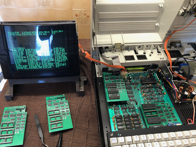

Managed to repair the 2000 monitor, time base issue with open circuit dry joint. The monitor is very bright in 80column mode so hopefully you have managed to resolve your brightness issue as it is the same monitor.
