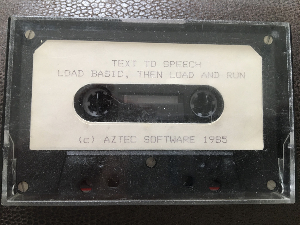

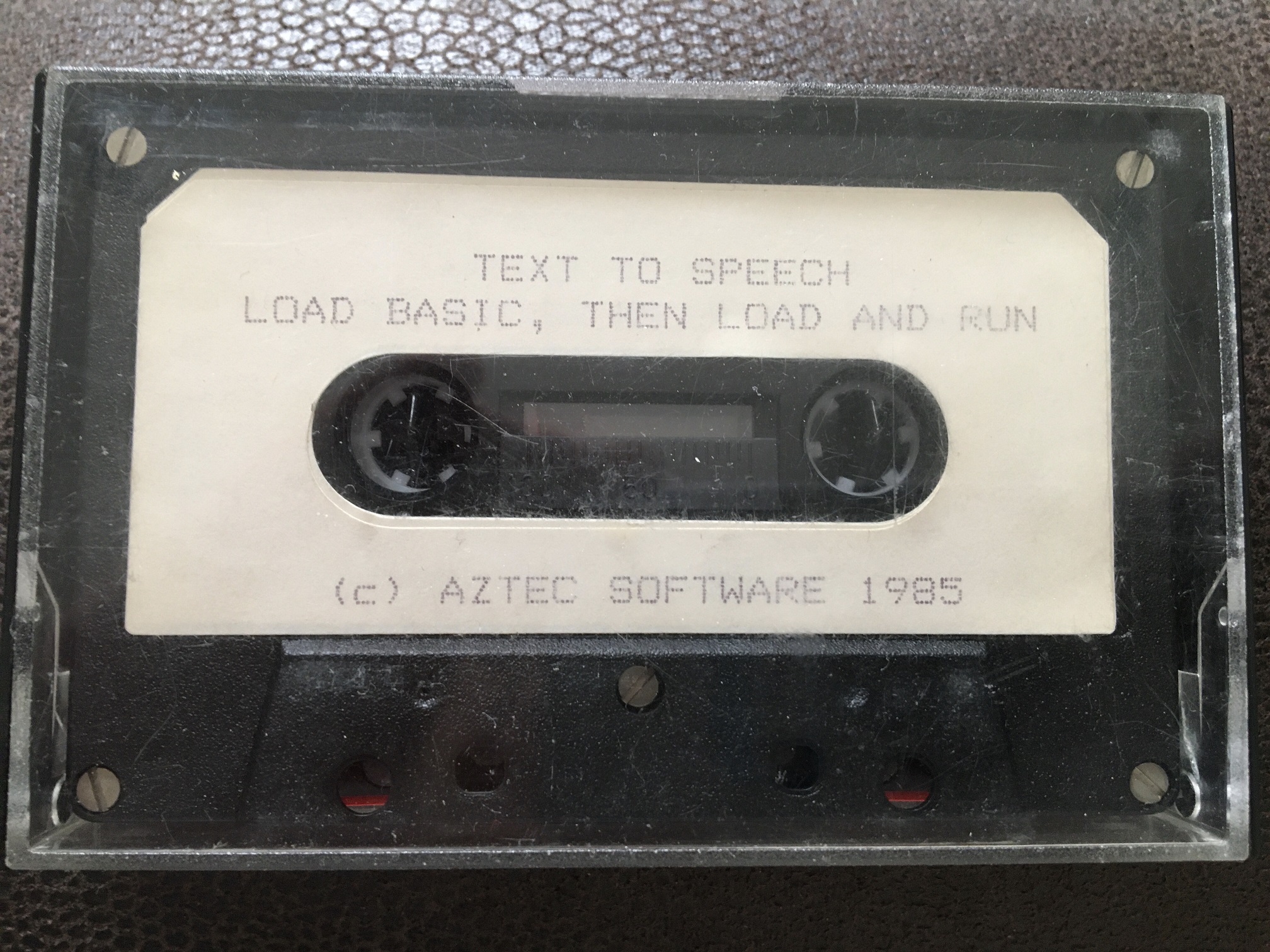

I've been trying to get this software (for the MZ-700) to work today on both the emulator and the real machine but it just seems to hang. Anyone know what might be wrong? Or perhaps it relies on some additional hardware.

It crashes due to there is no code a $C000 for the USR() call, there are no data POKES to, or a LIMIT set to protect the $C000 area.

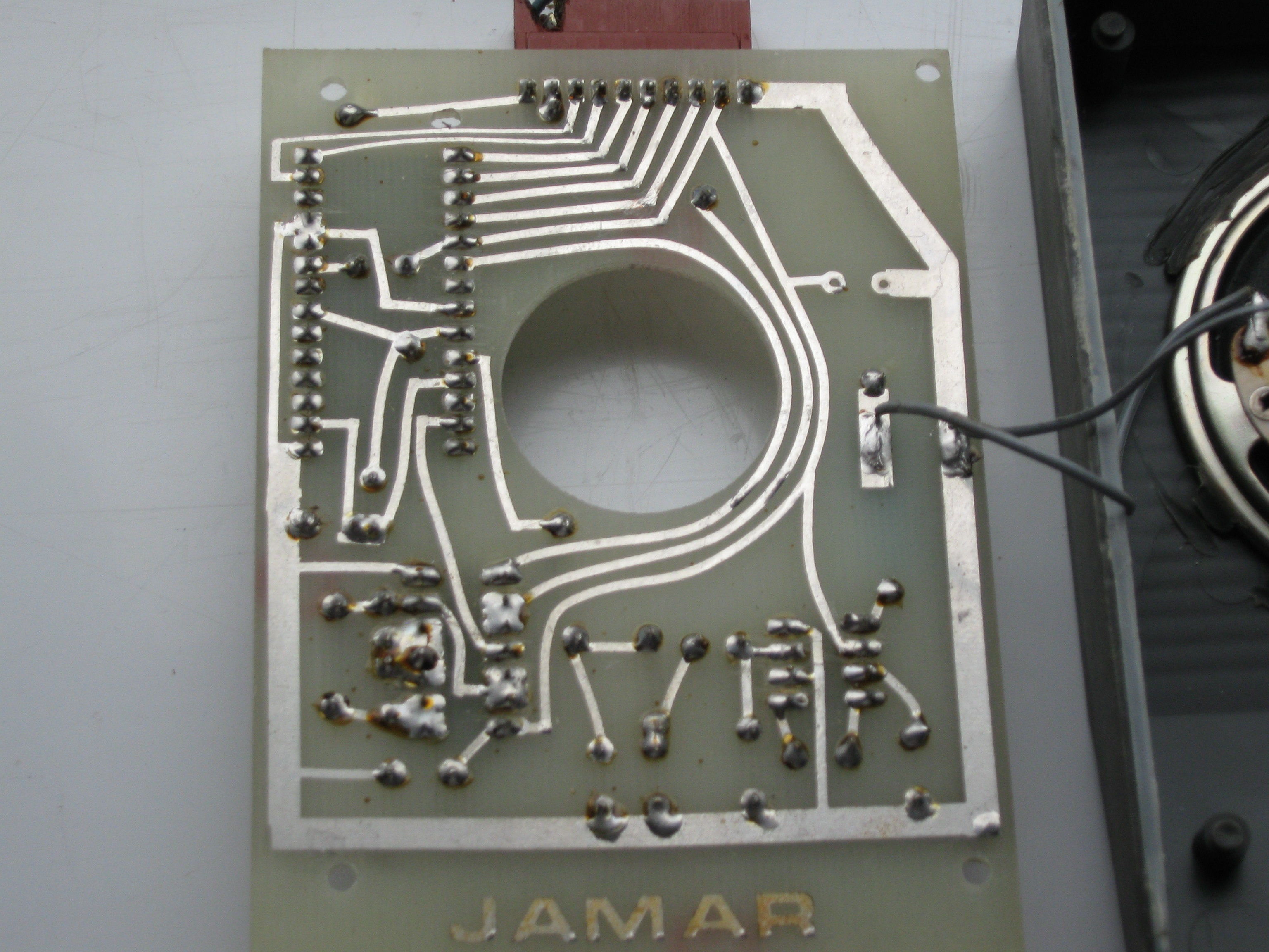

From the listing “USR($C000,O$), I think the program refers to the JAMAR Speackeasy (the micro speech module) that plugs in to the printer/plotter connector.

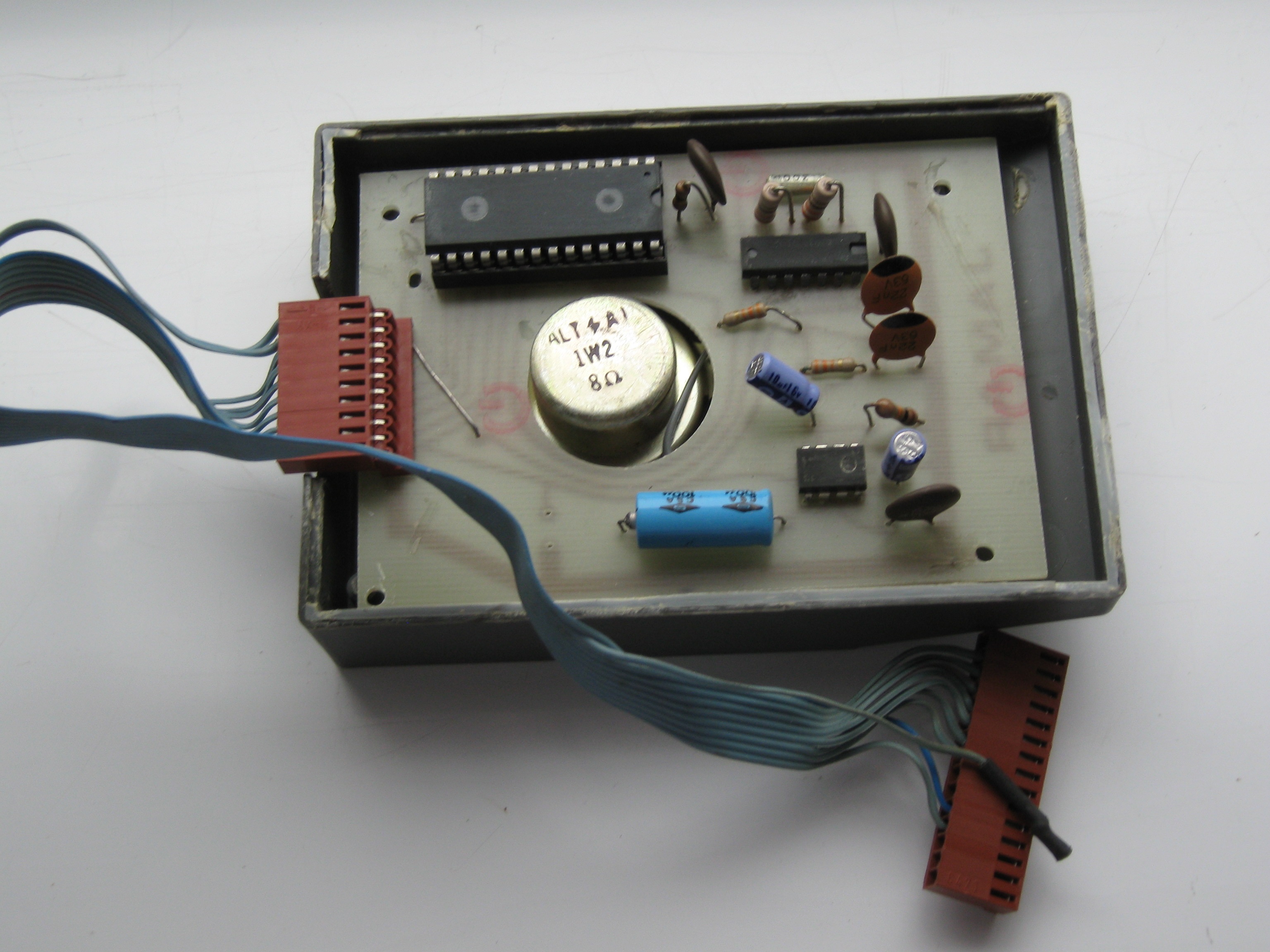

The micro speech module has a very simple single sided PCB with 3 DIL ICs,
1, 8 pin (amp)
1, 14 pin (logic)
1, 28 pin (sound)
There are no identification marks on the ICs they have been erased.

Well that answers my query as to whether I was missing any hardware! Very interesting, thanks!
