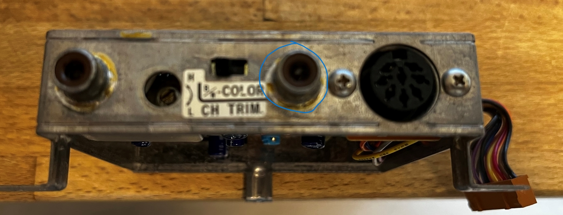

How can I invert? It is only one cinch cable(connector). And it works 100% fine on other 8-bits. I checked that it doesn't change polarity within this single connection as well.

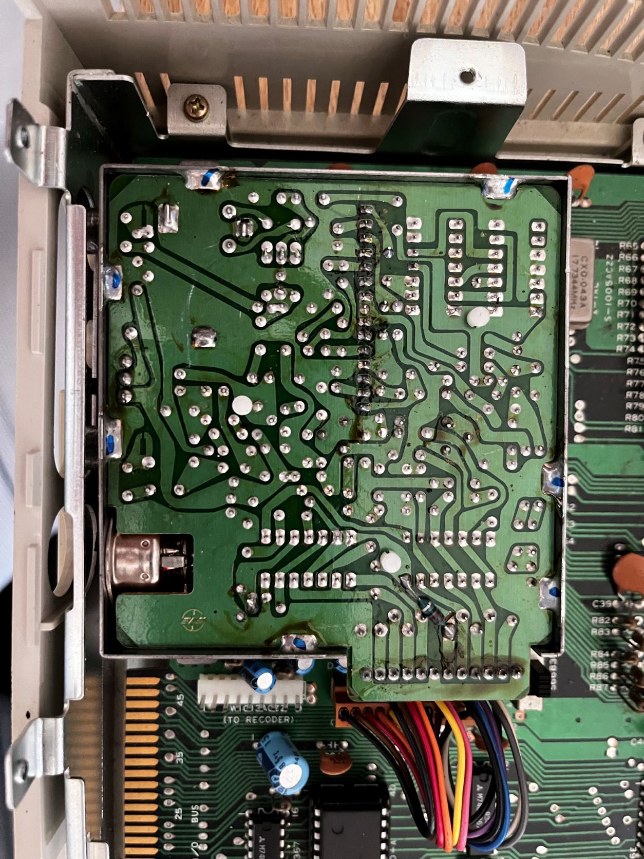

I connect it here:

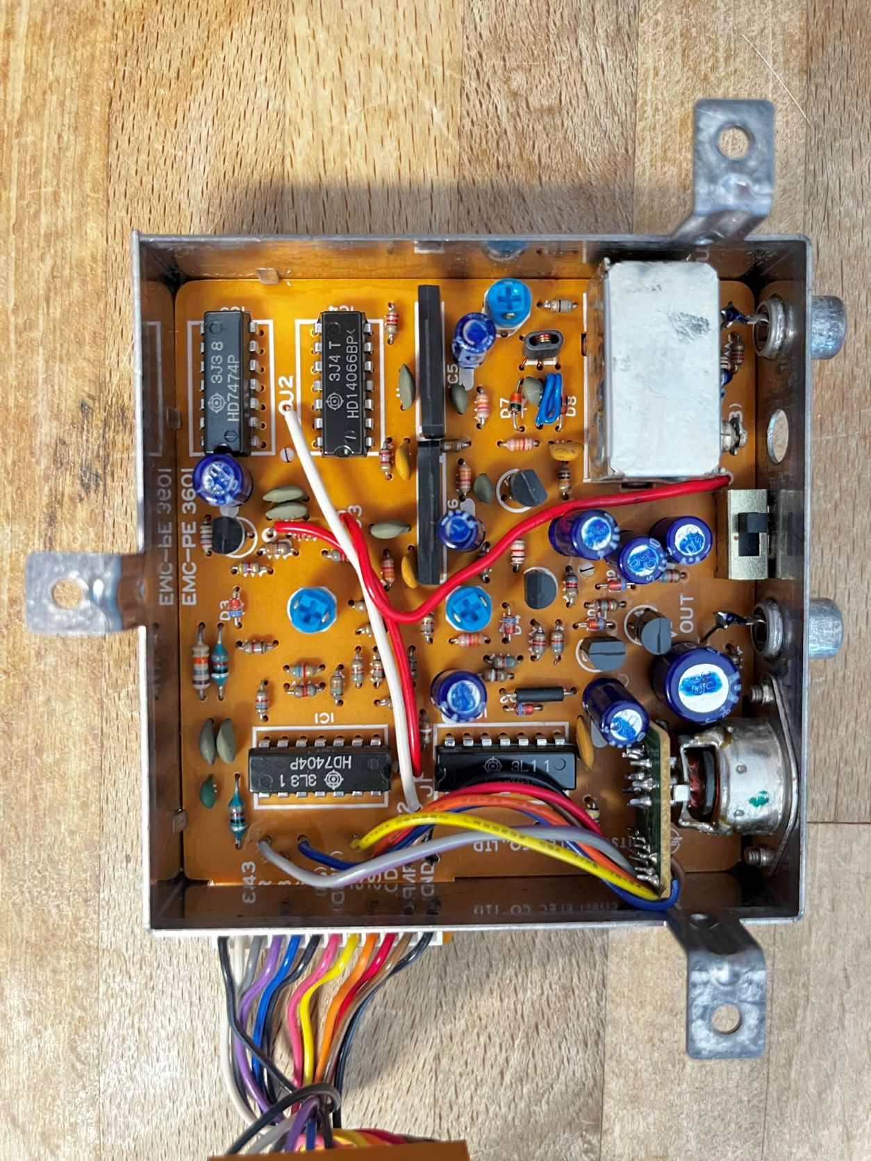

Here is the RF/video unit, case opened. I can see some hear has occurred around some solder joints, but this should not be the cause I guess.
Do you observe something suspicious?

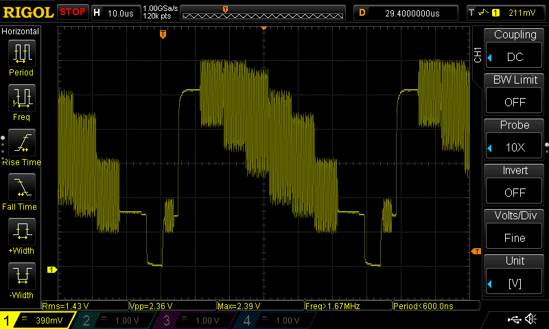

If you have an oscilloscope, you should probably check whether the signal is right. This one is for a color composite:

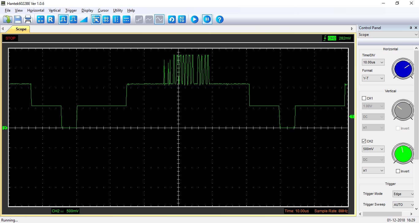

Here is what I got on a MZ-800 in monochrome monitor video output:

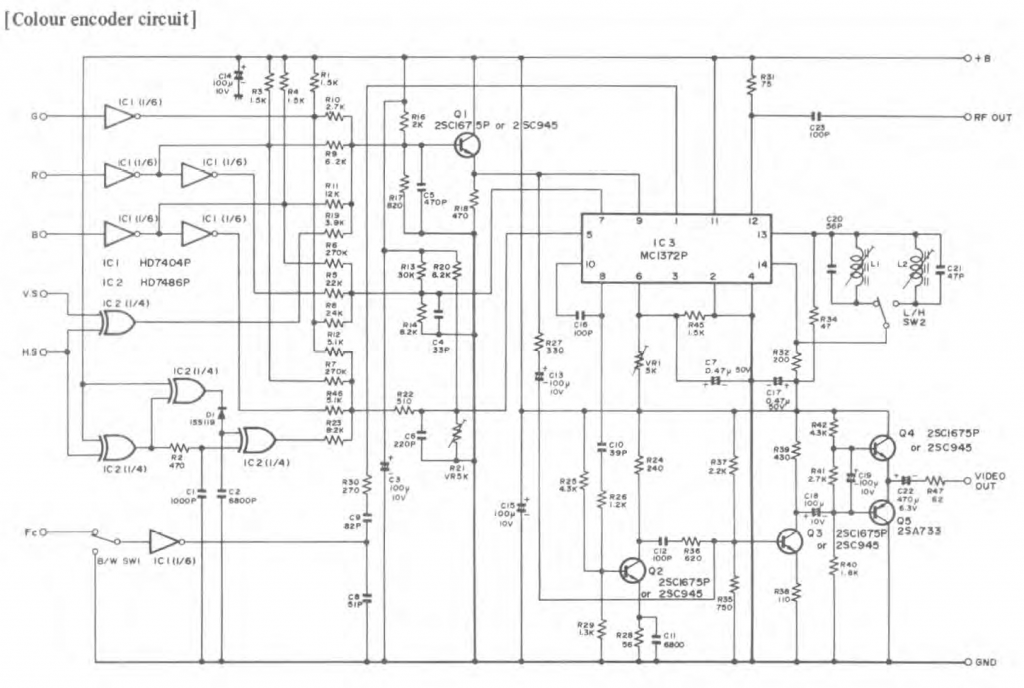

MZ-700 is only using 5V from the PSU and it seems you checked it. RF-box is only powered with 5V as far as I know. So the issue is about the current intensity (well that's the function of a fuse). I would say if you have a multimeter, put it in intensity mode with the highest max value and check what the intensity is. You could check on the power input of the motherboard, on the connector P-9 and on composite video from RF-box.
My assumption is the RF-box is the culprit. As soon as you used the composite video plug, it seems like there is surge of current. If you look at the schematic there are a lot of components between the input and your video output. Moreover, the schematic indirectly shows that the DIN8 is in "direct" connection to P-9 because that DIN8 is also TTL digital and you can't see that DIN8 in the schematic (and it makes logical why CVIDEO and CSYNC are done on the motherboard and not on the RF-board).
So if you want to check something, DO NOT use the composite output of the RF-board. Maybe the RF-out is working but catching RF on a TV is a big challenge. Or, simply use an Amiga SCART, connect R, G, B, CSYNC and GND to it.
With oscilloscope, you can check the CVIDEO (pin 3) on connector P-9 (unconnected from RF-box). It is not used by RF-box and seems to generate a TTL composite video with no color gradient.
