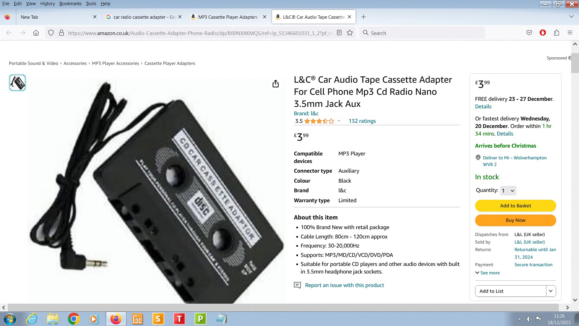

If you use a cheap Car Radio Cassette Adapter you can play WAV files direct from PC to your MZ.
See image this one is from Amazon and costs £3.99 but there are cheaper units

Thanks i will try. This item here costs 12€ ....
Hope the tape unit will close with the cable in it

Re: backing up MZ-80 Basic disk
I use the same car tape adapter and it works well with my MZ-80A. I have, however, made it so that I can remove the lid of the tape deck on my A any time I want so that the adapter can be used without the cable getting shut in the lid. I use MZF Studio to convert between MZF / MZT / WAV and the WAVs it produces always seem to work in my A.
