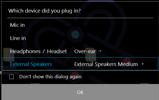

Here is what I get on my laptop when I plug my car cassette adapter into my laptop's headphone socket:
As I say, it took me a while to find the right choice here before WAVs started loading. I have to choose External Speakers (Medium) for it to work at all :)
