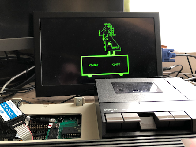

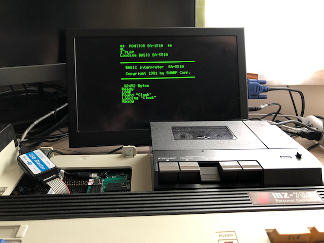

psmart wrote: Fri Jun 04, 2021 11:38 am I will take a look soon as Im currently porting my Sharp MZ Series emulator to a Cyclone IV device with less resources, modularising at the same time, once done I will advance by adding the missing FDC controller.
If anyone is interested, a Sharp MZ-80A running on a Sharp MZ-700 Host using the MZ-700 tape deck. This is a fusion of the Sharp MZ Series Emulator and real host hardware. I'm currently porting and modularising the emulator so that it runs standalone on the MiSTer project but also inside a Sharp host utilising original hardware where available.
EMUZ - 1.png (378.12 KiB) Viewed 53658 times
