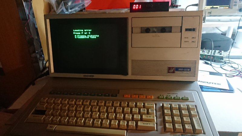

arnuphis wrote: Sun Jul 04, 2021 7:03 pm I actually ended up cleaning all the contacts on the edge connectors in the I/O bay and the pins on the MB and everything seems to be working now. I also switched over to the Gotek which works fine too.
@arnuphis. Hi,myfriend: I have connected Gotek with psmart SFD800 pcb on my 80B but I cannot make it work ,(in order to make some tests before proccess with my FPGA redesign stage ;) )
Could you please inform me of your Gotek FW and cfg settings? . I have also convert .dsk to .hfe on my usb . (Seeking led turns on with no loading)
Re: MZ-80b FI/O to HxC Cable
Posted: Sat Sep 25, 2021 5:47 pm
by psmart
If the card was working you should see the FD Loading error and a menu with C: CMT, F: Floppy Disk being presented. The screen you show seems to me to indicate only the CMT could be found. When you turn on the floppy disk should automatically activate and (on my HxC) stepping activity can be seen. If there is a configuration or data error, after a few retries you will get the Floppy error message + menu. If you dont have the disk (Gotek) connected and power on you should immediately get the Floppy/CMT menu.
Check the SFD800 card and the expansion box. Also, the 34pin connector on the SFD800 is in reverse so you have to reverse the cable (ignore the index plastic, force it in), I never understood why this was but duplicated the card as per the original.

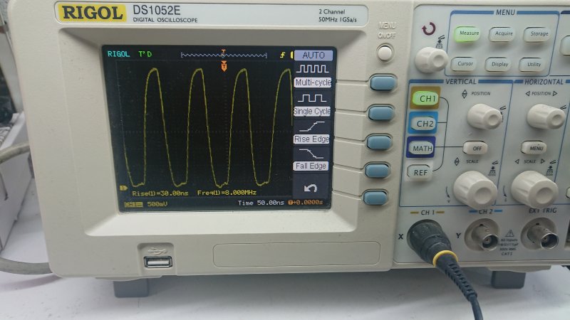

I checked if clock is alive (pin 18 on 1773) with my RIGOL and guess>>>>....no pulse. I changed to another 16Mhz crystal with no live pulse again.
This time I used other crystal 12Mhz & 10 Mhz and I got 6Mhz and 5Mhz output pulse (as expected!).
Weird! maybe both my 16Mhz crystal is faulty or fake (!)
I left 10Mhz on pcb to make some test. Per your instruction I get the C: CMT, F: Floppy Disk being presented message stepping activity present on Gotek led and I get an error-message+menu. With Gotek disconnected I immediately get the Floppy/CMT menu as you stated.
I think I am in the write path. Maybe there is image problem on SD or bad cfg file. (May arnuphise would be helpful here ;) )

Hi, the crystal impedance matching and capacitance is very important, i’ve come unstuck on my MZ80A video board with this issue, check the capacitors (on original one of them was removed as I guess the crystals specs of the manufacturing units were different to the design. On my first run of this board i had the same issue and had to reduce the bias resistors to 560R to get reliable oscillation.
Posted: Wed Sep 29, 2021 3:18 pm
by dat-alex

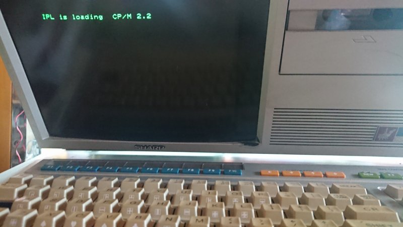

Well I changed one cap from 3.3n to 15p (I had in box) and now I get a clean 8Mhz clock output
Now it seems that something is going on!
I can get IPL loading message but stuck there... at boot
At least I know my WD1773 (and psmart pcb ;) ) is working maybe there is something wrong with Gotek .cfg or disk images
