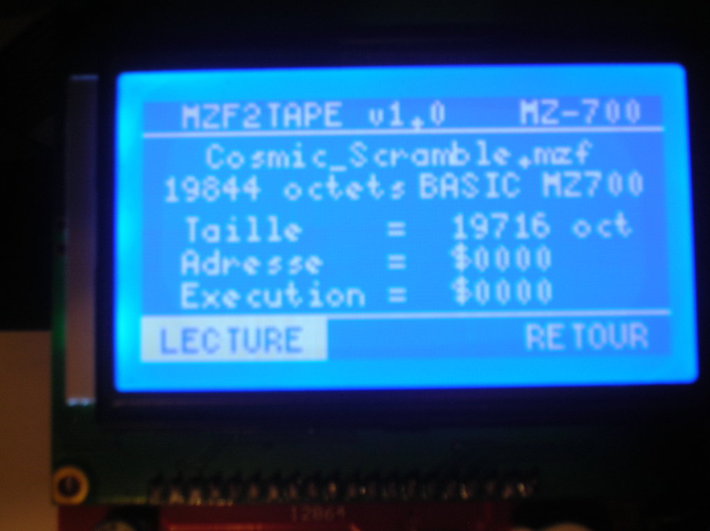

Hello to all the community,
I took over the work of hlide to be able to offer an interface for reading the files MZF, M12, MZT, BIN using a graphical display reprap discount full graphic smart controller. It contains a built-in SD drive and connects easily to an ATMEGA2560.
I planned to use several profiles.
I have not finished the project yet, but I can read any file under monitor 1Z-013A and under sharp basic 1Z-013b.
I will post all the work very soon: PCB card, ino program and connection diagram.

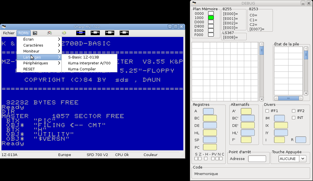

Enfin je suis en train de terminer un émulateur logiciel de sharp MZ-700 qui prend en compte les lecteurs de disquettes SFD700.

Finally I am finishing a sharp MZ-700 software emulator that takes into account SFD700 floppy disk drives.

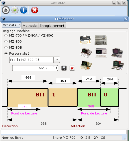

Emulator Sharp MZ-700
WAV2MZF automatic
WAV2MZF automatic
