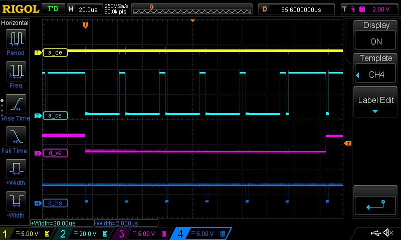

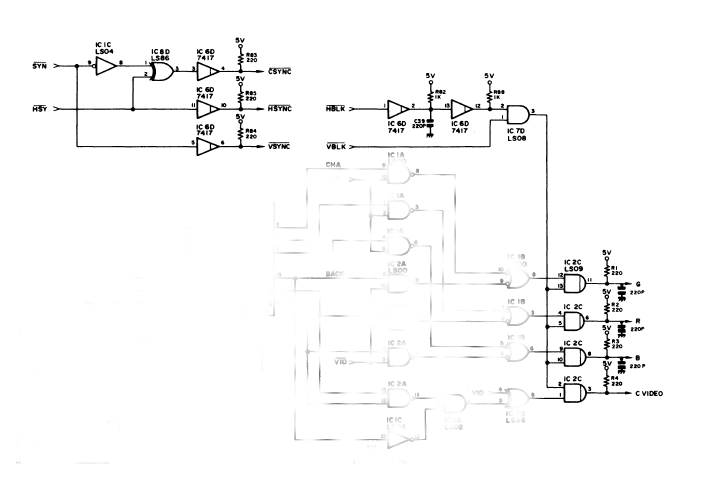

Argh... you're right. For some reason, I thought my SCART cable was using CVIDEO but I checked again the connection and it is /CSYNC indeed as it makes more sense here. What annoys me is the difference between CVIDEO and /CSYNC as I would expect/CSYNC be mixed in CVIDEO.
But the schematics says /CSYNC is an XOR of very short signals /SYN and /HSY while CVIDEO mixes an AND of very long signals /VBLK and /HBLK.

/SYN   | /HSY   | /VSYNC | /HSYNC | /CSYNC
0      |  0     | 0      | 0      | 1
0      |  1     | 0      | 1      | 0
1      |  0     | 1      | 0      | 0
1      |  1     | 1      | 1      | 1
That looks correct: either /SYN or /HSY must be low to get /CSYNC low. If both is low, then /CSYnc must be high so the TV can still detect their changes.

Just had time to double check and I was wrong in terms of the cable wiring when I removed /HSYNC+/VSYNC+CSYNC and replaced it with just CSYNC working. It was my new board that works with just CSYNC but on the MZ700, even though it is not electrically sound, shorting /HSYNC + /VSYNC + CSYNC together works on the original hardware. On my MZ800 it doesn't work, reading the article above it should so Im guessing CSYNC driver has failed (as you would expect when shorting signals together), will need to check and possibly replace the driver.
Lovely scope output, is that a PC based scope or standalone? I use a Micsig 4 channel standalone device which is excellent too, just great to have such detail. Gone are the days of the old analogue Tektronix (which I still have but has so many spider webs and rust, I doubt it will get used again!!!!)
