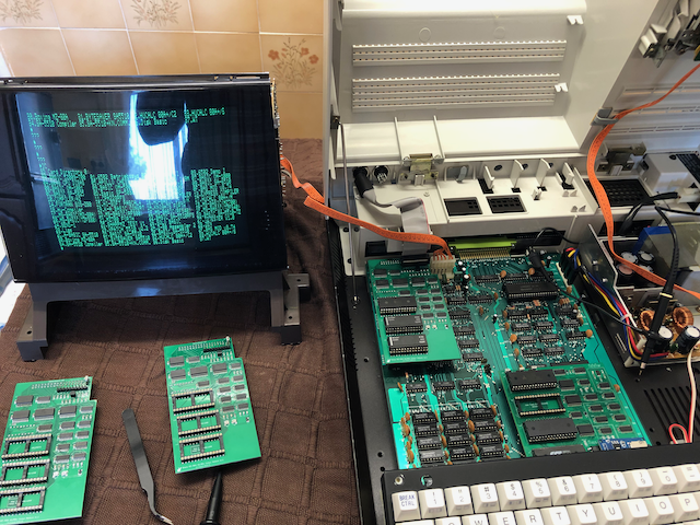

I recently decided to replace all the capacitors on my MZ-80A screen as the screen size was getting vertically smaller and couldnt be compensated with the vertical size/linearity (any attempt just started scolling). After completion, screen is back to full size, as per photo below and brightness is more luminance and crisp.
